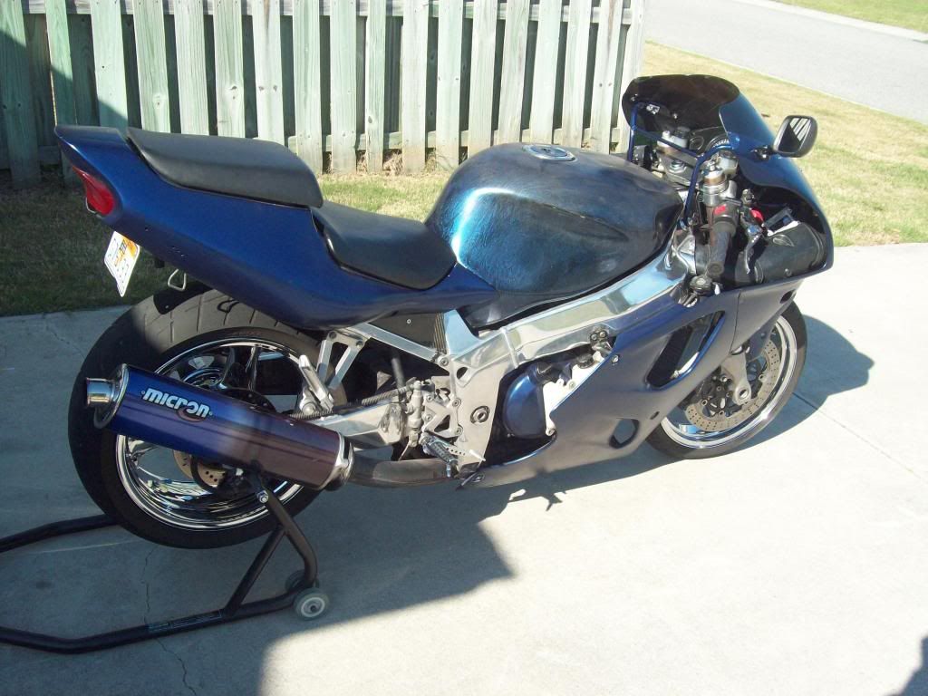

stands are had for cheap from places like harbor reight. i bought a rearstand for like, $40 and it's titties.
i f you've ever run thru any of my how-tos, you'll see i list "proper tools" "ghetto tools" and "universal tools".. always something to consider including in your list of stuff to prep for battle with. that way people can scan a list and see whats in store.
harbor freight stand in action. could make one just as easy too.
front stand is a close copy of this.
