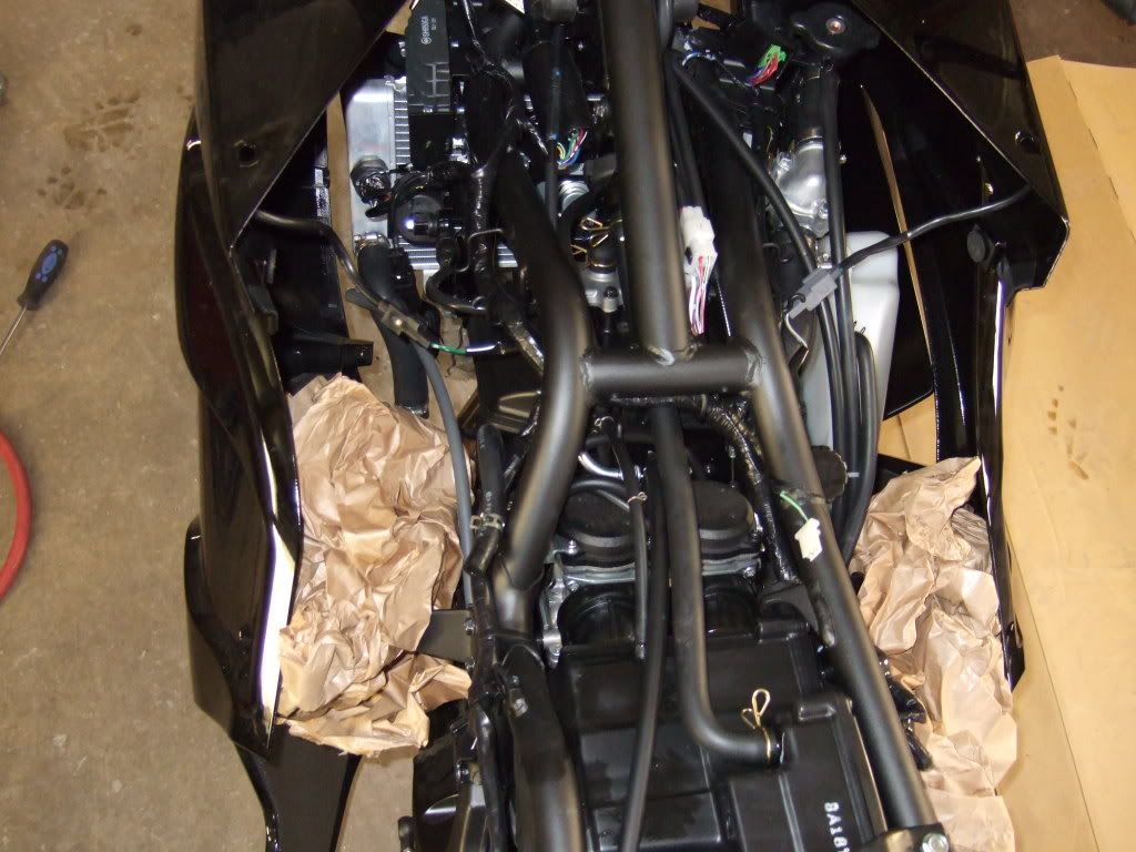

I chose to just hold the side panels out to the sides to get the tank off..you might just want to remove the panels..

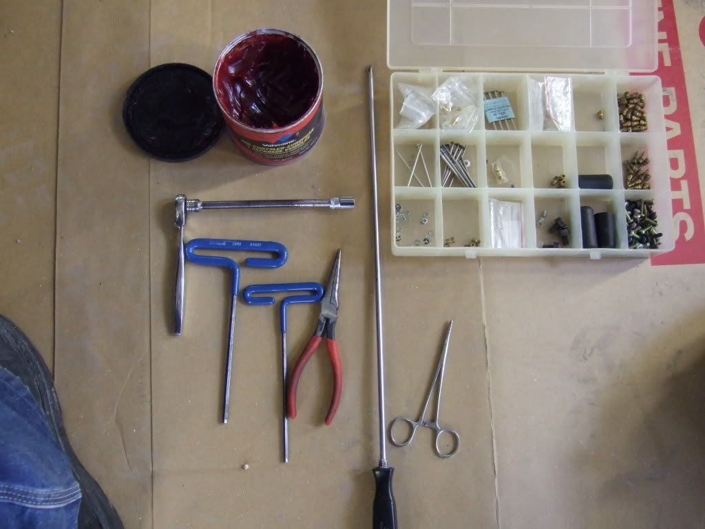

The tools needed or what I used..

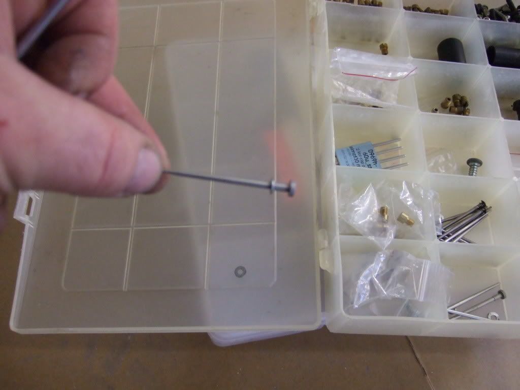

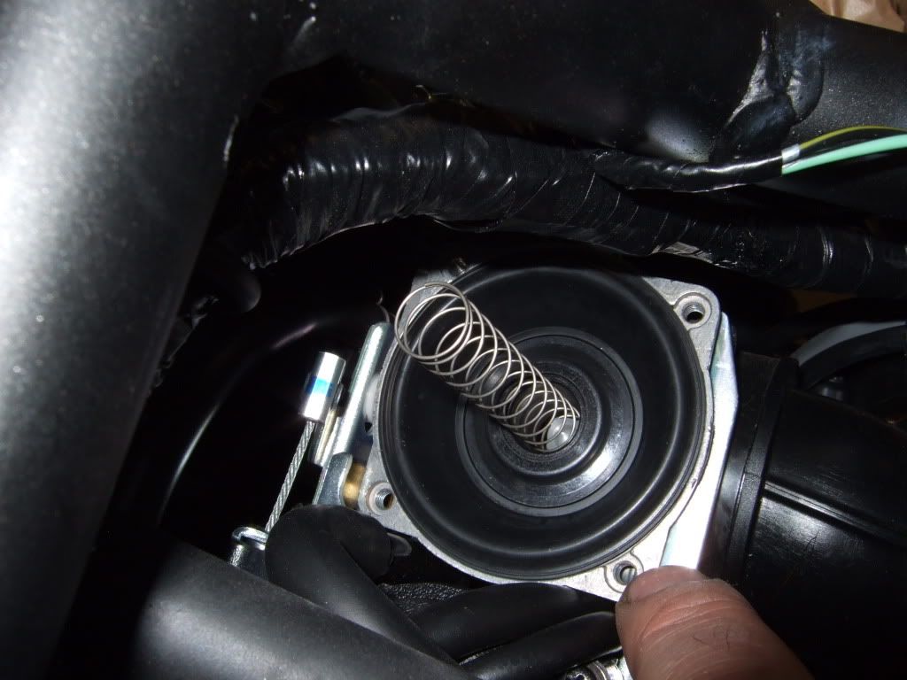

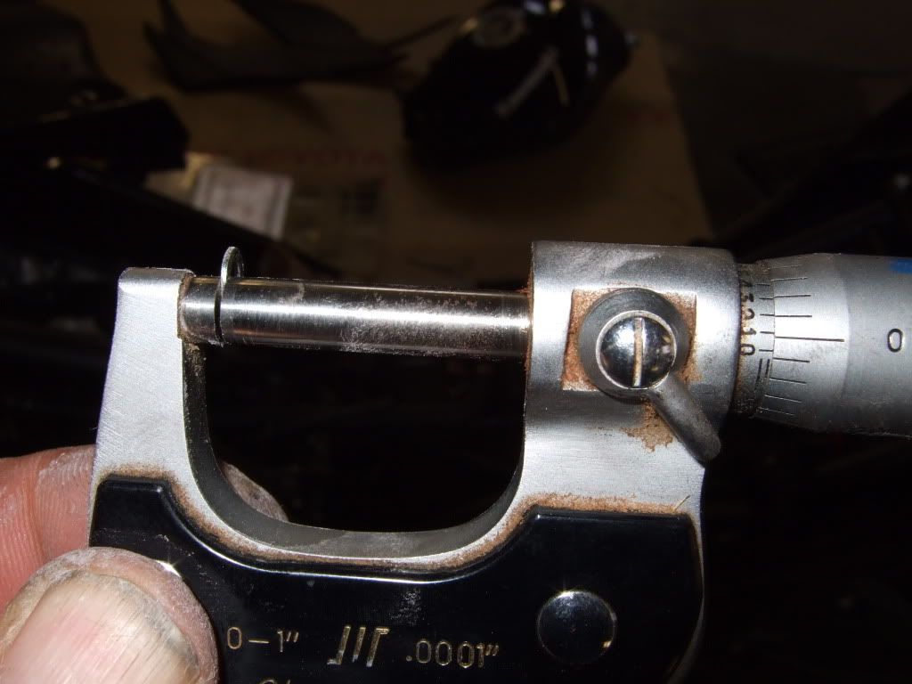

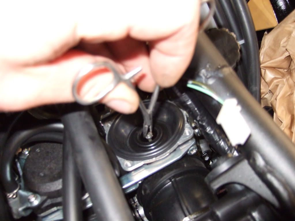

The needle can be removed like this..
The needle

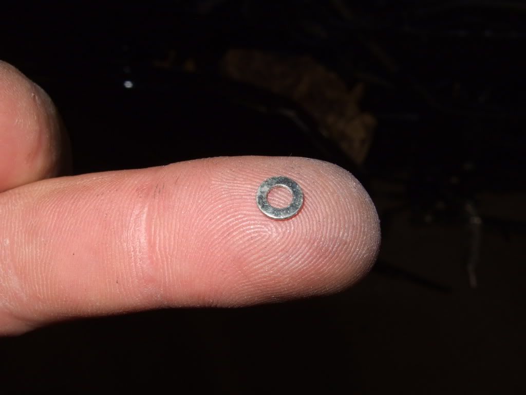

The washer is slipped over the needle like so..Use a dab of grease or vaseline to hold the washer in place for installation..I installed just one because I have just ratted out my stock can(see that mod posted in this forum)..I would recommend 2 washers if you are running a aftermarket can or exhaust...I did nothing to the airbox...

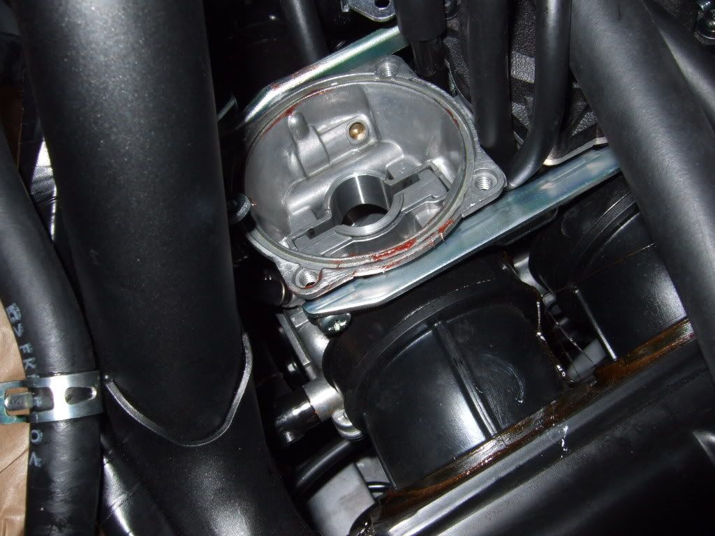

Be sure the rubber boot is down in the groove..THIS IS VERY IMPORTANT!! You could pinch the rubber and ruin it if not careful..
If the rubber comes out or you elect to remove the slide, put some grease or vaseline in the groove to hold it in place before assembly..
The washer is .025 thick and has a 1/8 inch hole in it..Hobby shop might be a good place to find them.
