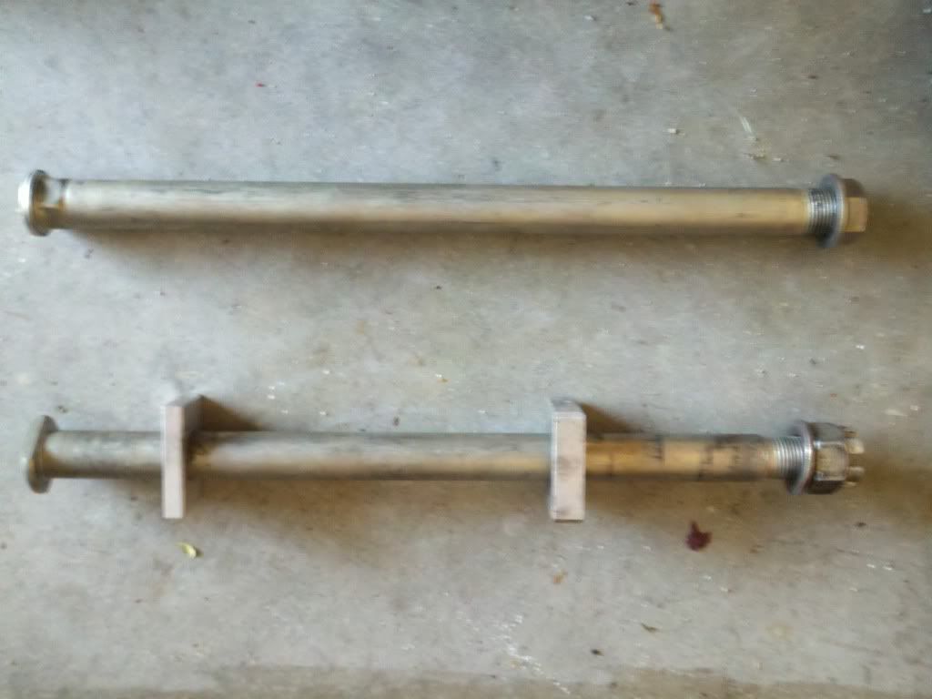

well im truly an idiot. i bought 2 sets of 25mm bearings and an axle and i dont even need them. our axle bolts right up to the 06-07 zx10r forks or i guess any set of forks that have a straight 25mm axle (see second pic below), as for distance, rake, and trail im not sure. but they bolt up to my forks with no new bearings needed. need to backspace the rotors and maybe larger wheel spacers but thats it, also the J stem could work with a 1" spacer under the lock nut.
as far as spacers go believe it or not our spacers (right side and speedo side) wont fit, they are too big for the forks which is easier than making them, might have to grind down right side one. im hopefully going to a electronic speedo so i might eliminate the speedo drive and get a spacer.
although these are the swinger and pivot axle the 06-07 zx10r uses the same straight axle up front making the fork hole truly 25mm.
