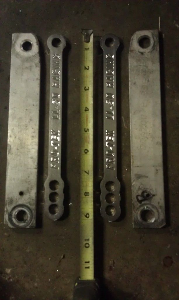

He already has longer dogbones. Why would he need a set of adjustable ones?
Op, you should be able to find a set of stock dogbones om ebay easily.

Well I just took a look under the bike and it looks like the guy I bought it from made the links him self. Depending on how much the stock ones cost I might get some adjustable ones and just raise it a little. The main reason I want to raise it, is do to the fact the fender has a hole rubbed into it from how low its sitting. Are there any brands to avoid? There are some PRO-TEK ones on ebay for $40 shipped, are those any good?

Well I got some adjustable links, and got them installed. I think the bike handles so much better. I went from a 5" drop to a 2" drop. Now I just need to figure out if the front has been lowered or not.

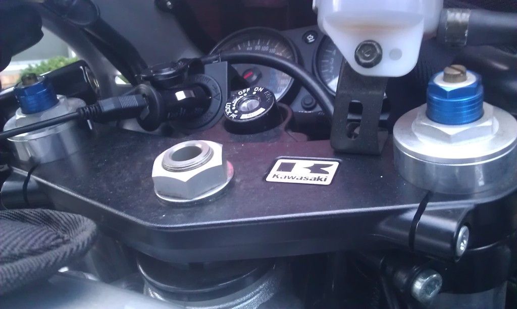

Post a pic of the fork tubes in the top clamp and one of the pros here will be able to tell you how much its been lowered just by looking at it. But after looking at thoes homeade links I bet the previous owner just lowered the front with $2 tie down straps from harbor freight.

I haven't been able to take pics, but my buddy told me its been lowered as there are a bunch of threads showing or at least more than normal. I will get a pic up asap, but in the mean time it looked like there was an inch of threads showing on the tubes. With the bike lowered 2" from stock in the rear the bike almost sits level compared to the front. There is a very small amount of rake

If you're not too short of a person, I'd raise the bike back to stock height. I'm 5'4 and 130lbs, riding my rear shock to it's limits with the compression turned out 3/4 way (due to milage but never got it lowered).
Whenever i get a steering damper on, I can drop my forks about 5mm to keep the front down a bit more when accelerating out of corners full pin.
A lowered front makes the steering more twitchy = high risk of tank slappers/speed wobbles.
You mentioned a bunch of threads showing. if those are the preloads, that doesnt mean much other than soft suspension. Only if the forks are pushed up and dont sit flush with the triple tree anymore, it has been lowered.

I am 5' 10" 215lbs. I just got used to the higher ride, and think I am going to go all the way back up to stock.
Here is a pic of the front
