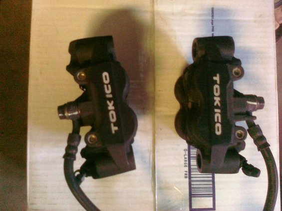

Just as the title says, here are the 09 CRB 1K Tokico monoblocks.
It has been said that these perform on par with the Brembo monoblock M4's.

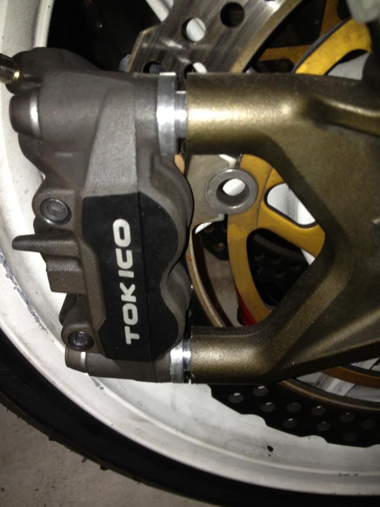

I was able to pick them up cheap and adapt them to the Kawi forks relatively easy.
I used a modified Honda 5mm spacer. Part # 51497-MEL-D20
It's somewhat dark in my garage so forgive the shadowy pictures.
On with the pics:
1. Tokico monoblocks off an 09 CBR 1K
2. Calipers mounted with 5mm spacers
3. Black rear caliper off 08 ZX6 to match fronts, and relocated rear MC reservoir(completely hidden with plastics on)

I'm missing the braided hoses... getting one-piece calipers but using them with rubber lines is just funny... get some proper brake lines for that brick wall effect. just an idea! are these real monoblocks? anyone could post a picture of the other side of the calipers? the nissins were 'so called' monoblocks but they're 2 piece designs. Though they're stiff as hell...
Yes they're real monoblocks :D, no the Kawi Nissins are not(although a fine set of calipers), and as the setup currently sits, I really like the feel of the brakes. I don't see the need for braided lines on this bike, the RR lines are fine. It still maintains a somewhat progressive feel, which I prefer. I don't like the "on or off" feel, or the brickwall effect as you put it. But thats just me.

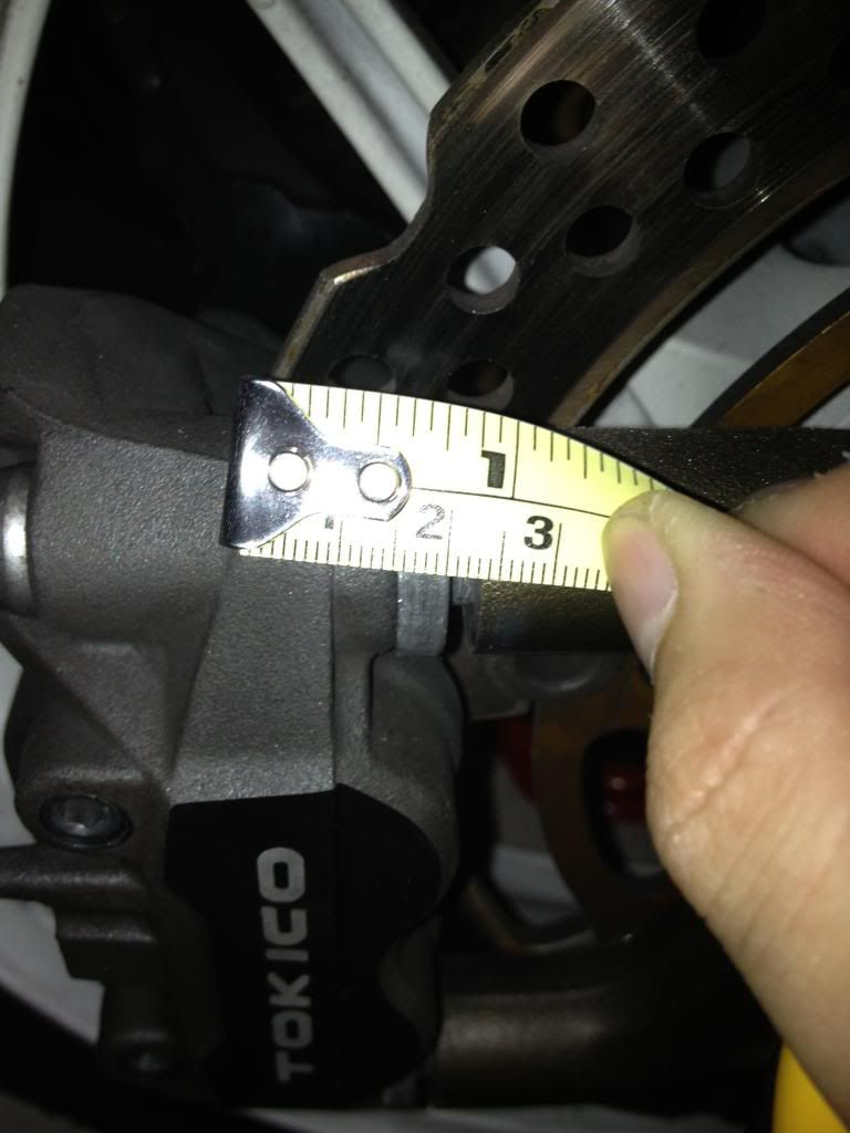

I bought some 5 mm spacer but they have the "lip" on both sides.
Im assuming you shaved the lip off one side to make it "modified" ?
If I shave that lip off is 5mm good enough to have the pads grab the rotors at maximal proportions?

Yeah, they'll work with the shaved 5mm spacer. That's what I used.

Thanks, I need to pull it off and start grinding those spacers then. Any tips? I think im going to use my dremel and shave off the lip slowly
