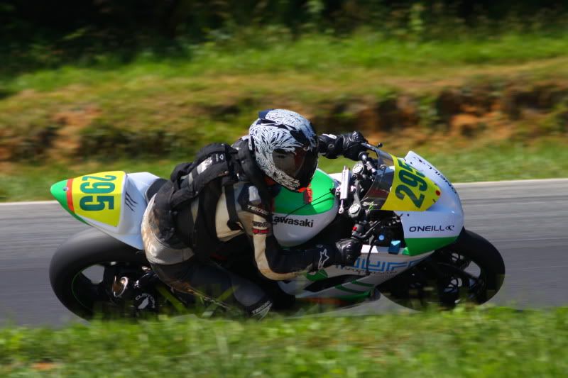

Picked up a trashed 09 ZX6R, bald tire, cracked oil pan, lowered GSXR dogbones, half of the fairings missing, teeth missing from front sprocket.
We worked all day and night for a record build to get it ready for the race track...Immediately stripped the bike down to the motor and frame, installed a new oil pan, K&N filter, Motul oil, raised the back end with stock bones, deleted servo and unnecessary weight (sprocket cover, hugger, turn signal controls, etc.).
Installed new Pirelli Supercorsa tires, Galfer SS lines, Factory Bodyworks race fairings, Woodcraft CFM case covers, Pitbull spools, Woodcraft Clip-ons, BMC filter and modified airbox, Full GP style exhaust, Power Commander with custom race tune on the dyno, Vortex keyless gas cap, Vortex sprockets and RK chain. Tuned the stock suspension for my weight and race pace. Went for a little test and tune...
Added custom graphics and off to the races to take a few top 5 finishes, one 2nd place, and narrowly missed out on two 1st place finishes.
Good enough for BOTM?????

Probably a dumb question but what are you wearing over your race suit in the one picture? I thought it was a bookbag at first.
1,713 Posts
Pure Sportbikes,
i was about to ask the same thing until i noticed the cord running to the damper area
then i recognized it to be similar to RS Taichi's T-Raps system
OP, have you had to actually use that airbag?
if so, could you post a review
reusable?
i wouldnt mind getting that for commuting
reusable?
Yes, that particular one I crashed in 5 times. I was able to repack it the first 4 times. It's a simple fold and snap for the airbag section, and you install a new co2 canister. Takes less than 5 min. I've been really impressed with how it really works and holds up to abuse and abrasion. On the last crash it finally wore through on a very small section.
As far as crashing is concerned, it feels like crashing on pillows, or that you aren't crashing at all. Really a cool feeling, if you can describe crashing as cool at all. It inflates around your neck and down your chest and back, down to your tailbone, so there's plenty of protection. I enjoy riding knowing that I've got the extra protection available to me. I've felt what it feels like to crash and tumble plenty of times without it...BIG DIFFERENCE!!!
