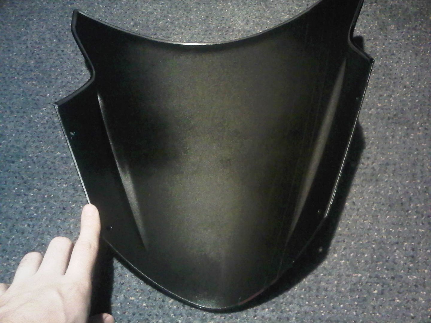

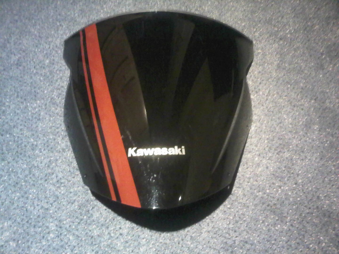

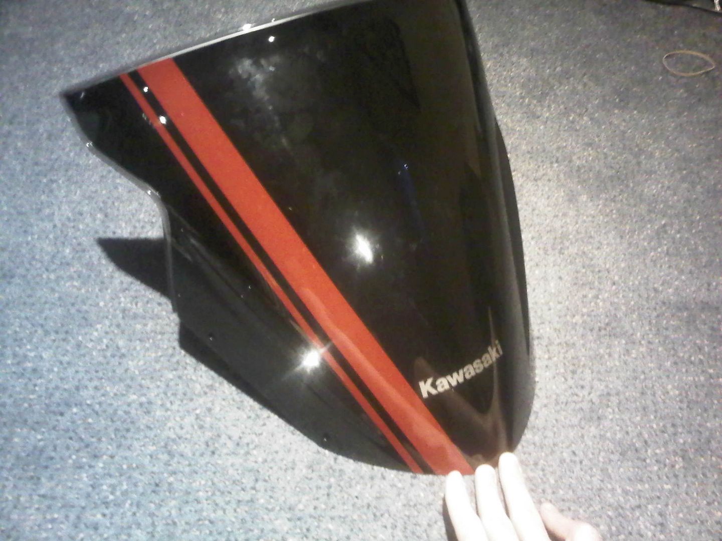

So I have officially finished my first bike mod... here are some pics to finish off this little album...
N.B. It came out ridiculously nice!!!

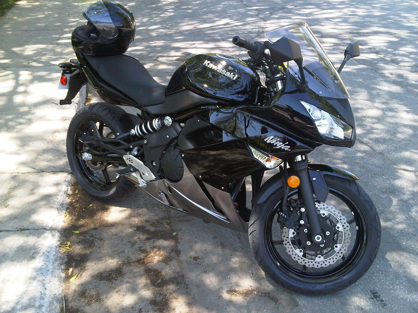

can we see a pic of the final product on the bike? it looks great! :)

This turned out really fantastic! I never would have thought of painting the underside of the shield to make the final outcome look glossy from the other side! My dumb self would have screwed it up royal! Great bike man!

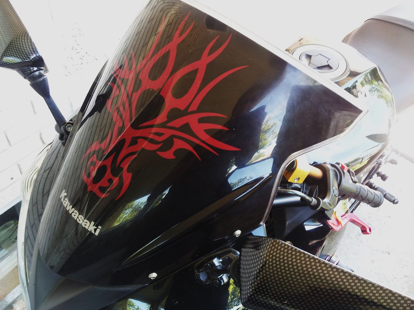

I bought a decal off ebay. I followed all the other steps that Kanellopoulos00 gave. Thanks for the idea :)
