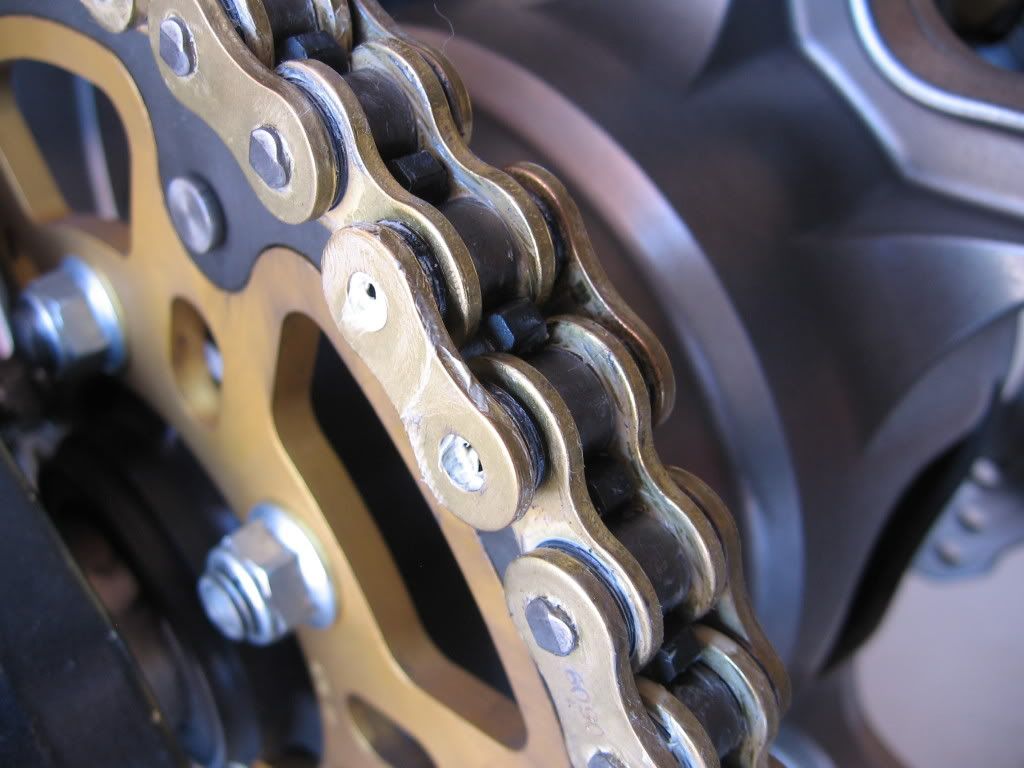

Step 3: Put the bike in neutral and slide the new chain through the front sprocket and wrap it around towards the rear sprocket. Use the rear sprocket to get the two ends together.
You may have some trouble getting the two ends together, if that’s the case, loosen up your chain adjusters.

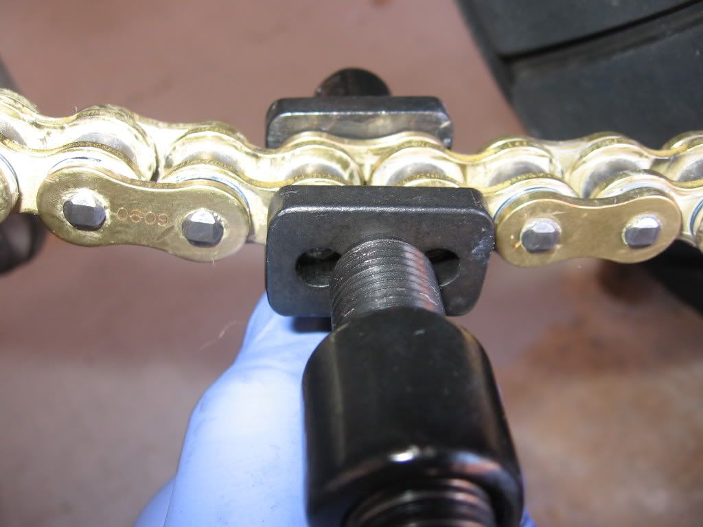

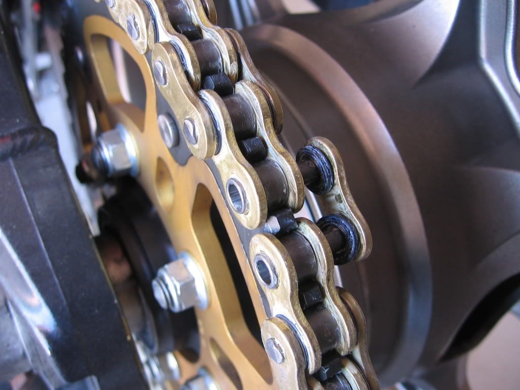

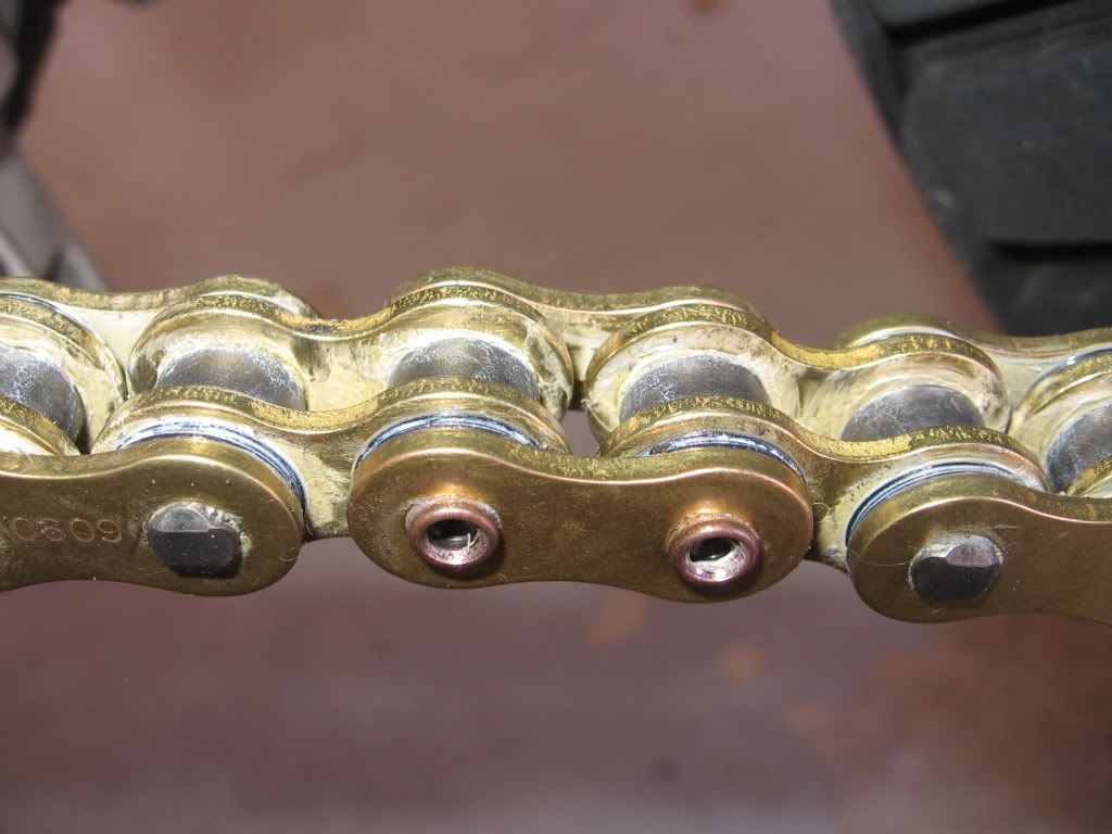

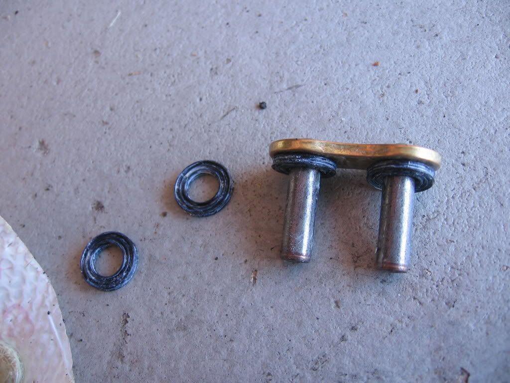

Step 4: Take your new master link and install 2 o-rings (1 in each pin) and insert master link through the chain. Install 2 more o-rings into both of the pins and install the face plate.

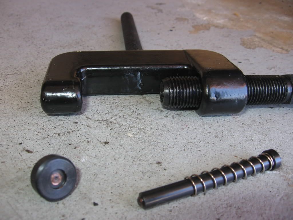

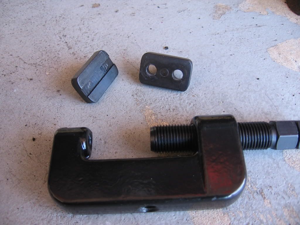

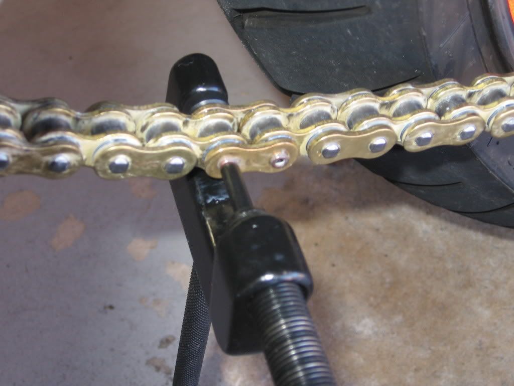

Step 5: Press the face plate using the correct tool as pictured.
Step 6: Now the master link can be riveted by using the riveting tool and the correct size anvil.

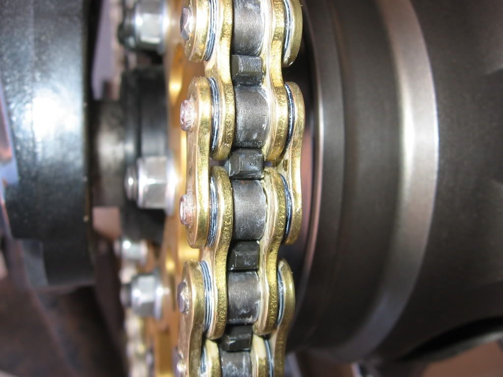

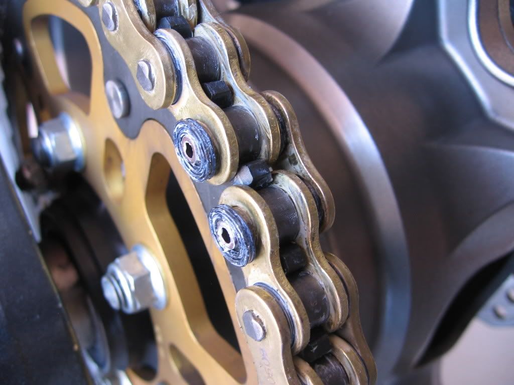

Left side is now riveted.

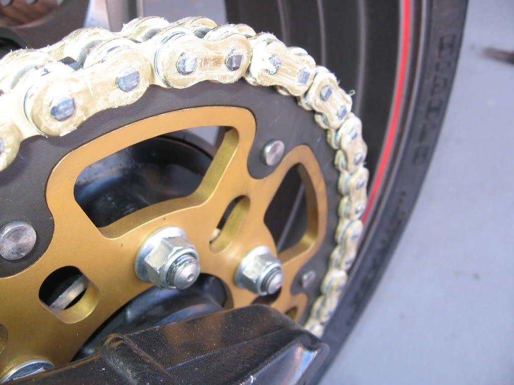

Both sides are riveted.

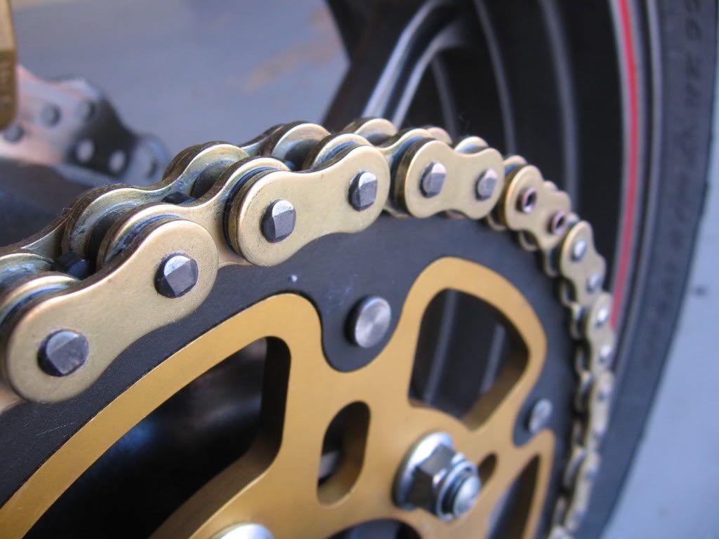

Step 7: Ensure that you have proper chain slack and adjust accordingly. As mentioned by ryan97812, it is a good idea to wipe off the excess lube to prevent from flinging-off and getting you and your bike dirty.
Enjoy your new chain!
