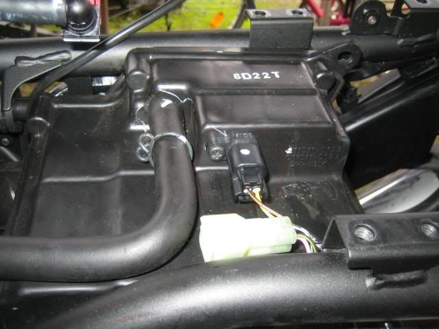

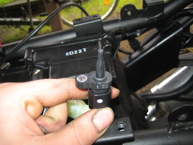

This sensor is mounted in the airbox.. but i think it is some sort of airtemp sensor to ajust the air/fuel mix in cold and warm weather... but im not sure...
When i disconnect it and start the bike the FI lamp is on... so it would have to stay on the bike... but i think i could just let it "hang" someplace on the bike... but what do you guys think???

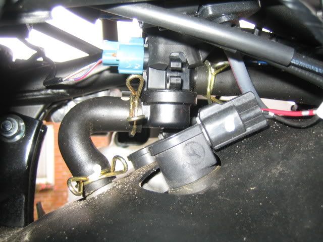

This unit is mounted in the same place as the kleen air system on the carb bikes... it has two hoses and a plug on it (the blue plug)... one of the hoses goes to the cylinder head and the other goes to the airbox...
I dont know what the sensor in it does... but could I put a breather filter on where the hose to the airbox is mounted???

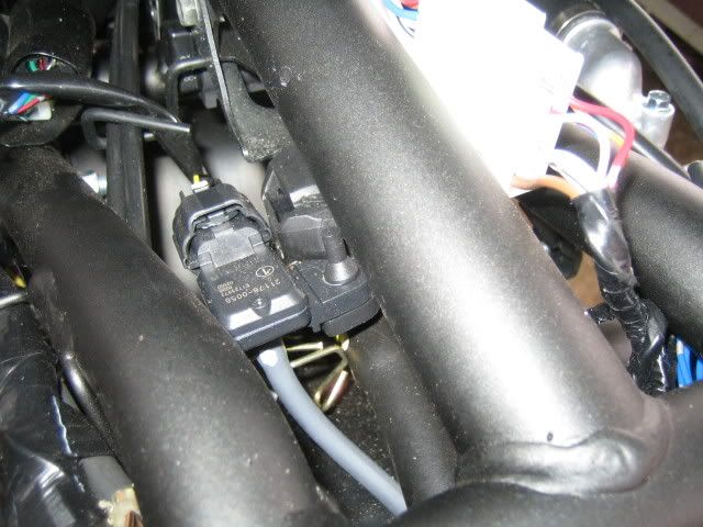

I do not think it is some sort of MAP-Sensor or vacuum sensor for the intake system because next to it is mounted a sensor that has a small hose going to the throttle body... I think this is some sort of MAP-Sensor...

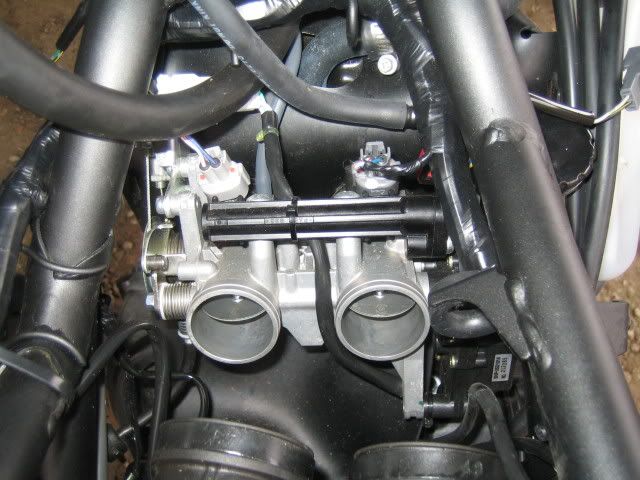

The throttle body flange diameter is 44mm (1.750in Sorry guys... I'm metric) I can see the airfilter VeX used on the carb bike has an inside flange diameter on 48mm (1.875in)... What size is the carb flange and do you think i can tighten it in so it fits???

For that first sensor(air temp), just put a hole in the back side of the pod filter and mount it there. Another member did that for the AIS hose (cant remember his name).
For the blue connector on the AIS valve, looks like the ECM controls it(valve). The carb bikes it vaccum controled. On my other FI bike I just disconnected it and removed the AIS crap, it doesnt throw any codes. Try disconnecting it and see what happens if you wanted to remove the AIS stuff. If you leave it, connect the AIS hose to the pod filter. Anyway, if you decide to remove all that crap, and it has a code. You will have to leave the valve with the connector, or read the value of the valve and try and fake out the computer with something(resistor).

Oh, Iam with you on the 3rd sensor too. Has to be MAP.

Pic #3, kinda looks like the bike has a different ingition system too. Like each cylinder has it's own coil ?

On your first post, the last picture of the throttle bodys. Were you holding the throttle open for the pic? Just wondering if theres two set of throttle blades..

No I'm not holding the throttle open.. but there is two sets of throttle blades... it looks like its controled electric...
