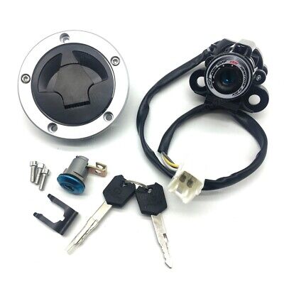

And I also found this set on ebay for 70$ (theres cheaper as well)
This set is for the ZX-6R and thinking that it should fit since some of the part numbers are the same. Couldnt find the full lock kit for the 650.

Pretty sure the cap comes off without having to open the tank but not 100% sure
Generally If the parts match in number then they should fit.
the main issue may be wiring and fit of the ignition. But again, if it’s the same part number ....it should slot straight in

  • I think I got it figured out. None of the dealerships record the information for the key code in there files. So they cant give me shit lol. But I think I just need to get some blank keys. Take the Ignition out and use the key code that's imprinted on there at a locksmith to have them cut the teeth down to the proper size referenced from the key code. Supposedly there are cheat codes on the gas tank and rear seat lock. But from what I've heard the gas tank needs a key to come out and I am most likely to damage the bike if I just go to the ignition. In order to get to the Ignition, I need to take the triple clamp off (at least loosen I think.) Then I possibly might need to drill the security (break away) bolts out of the ignition to get access to that key code. If anybody has done this before or has experienced please let me know. I'm hoping this route Works instead of having to go through buying a whole new lock set. Or paying the 175$ to take the bike down to the locksmith and have them mold a key from the ignition.

I’ve done a front end swap on mine and so I can check and see where the number is and whether it needs drilling out.
if you do need to drill then the easiest way i found was to take off the triple and flip it upside down. Clamp it on to one leg of the bike while you drill. This way it’ll stay steady You can trace the wiring back and unplug it to put it in a vice but the plug is a bit buried in the bike.
I used a fine pilot drill first and then went bigger and bigger until the head of the screw cam off. The bolts are 6mm and sharp drills made short work of them
