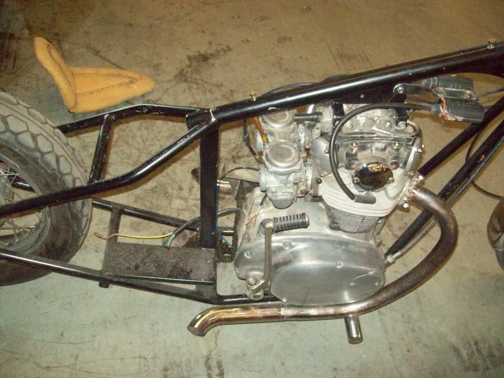

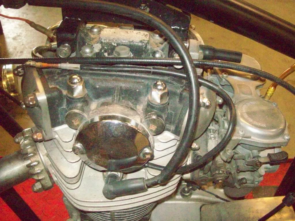

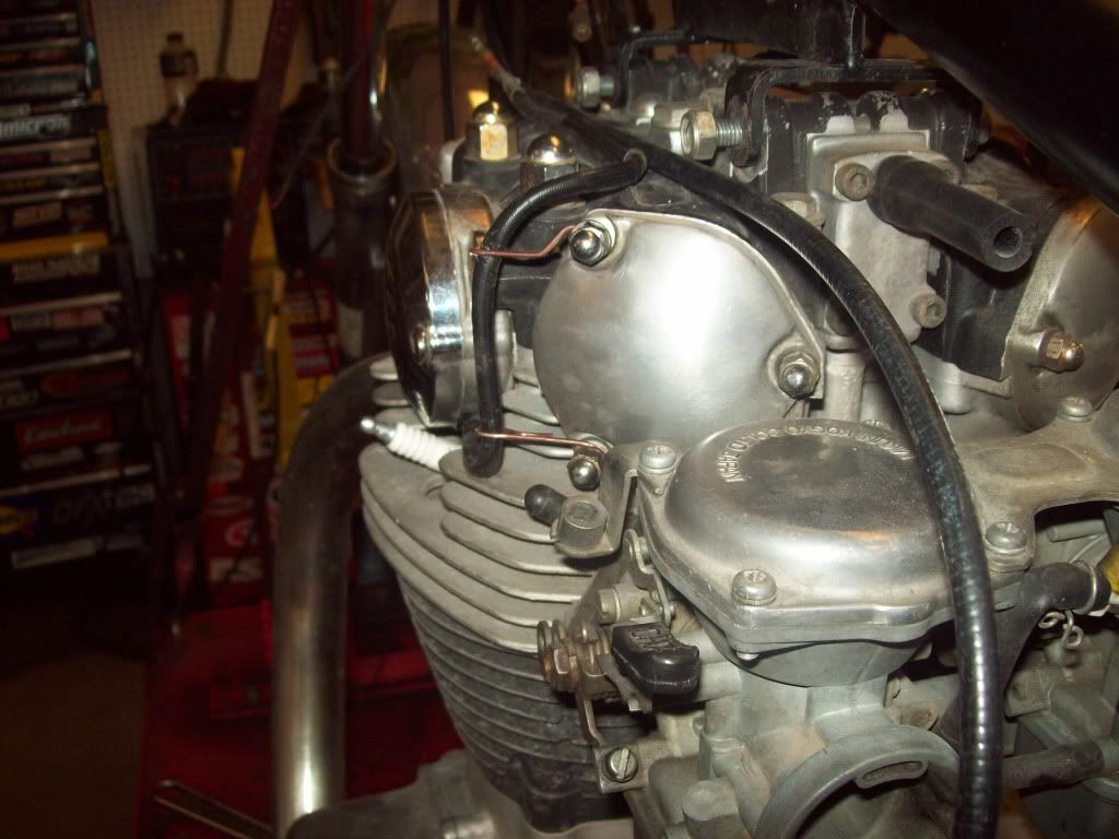

mid or late 70's xs650 bobber build. got it fired up today. re-designing the charging system. false tank under the seat holds the electrics, some switches.

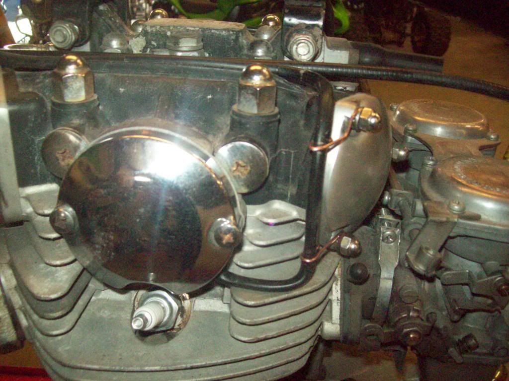

went thru and fixed a hanging float in #1 carb today. fired right off after putting oil in it. should be a cool bike when i'm done. pretty much my project bike and my initiation into the new shop i'm at.

well. lots more to go. going to rip the motor out probably tomorrow or tuesday and once i get my tig rig to the shop, go over EVERY joint on the hard tail swap where some shit was only tacked with mig.. zap the batter box and false tank and seat brackets, wire supports and misc shit.. then off to the powdercoaters with some more brackets i'll make for the single speedo and H-D headlight.

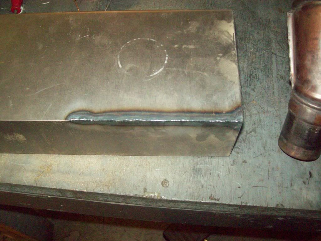

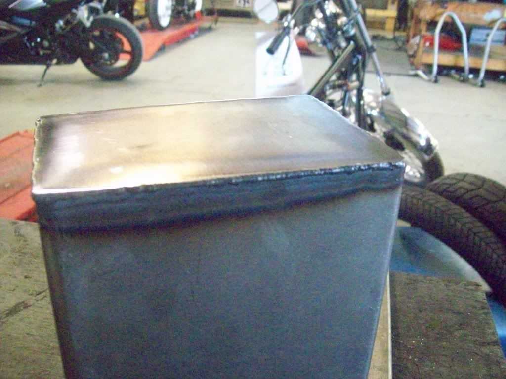

moar. the other bobber.. battery box fab wirth NO press brake! because i'm fucking baller like that.
fuse welded. (autogenous welding) 22 gauge mild steel.

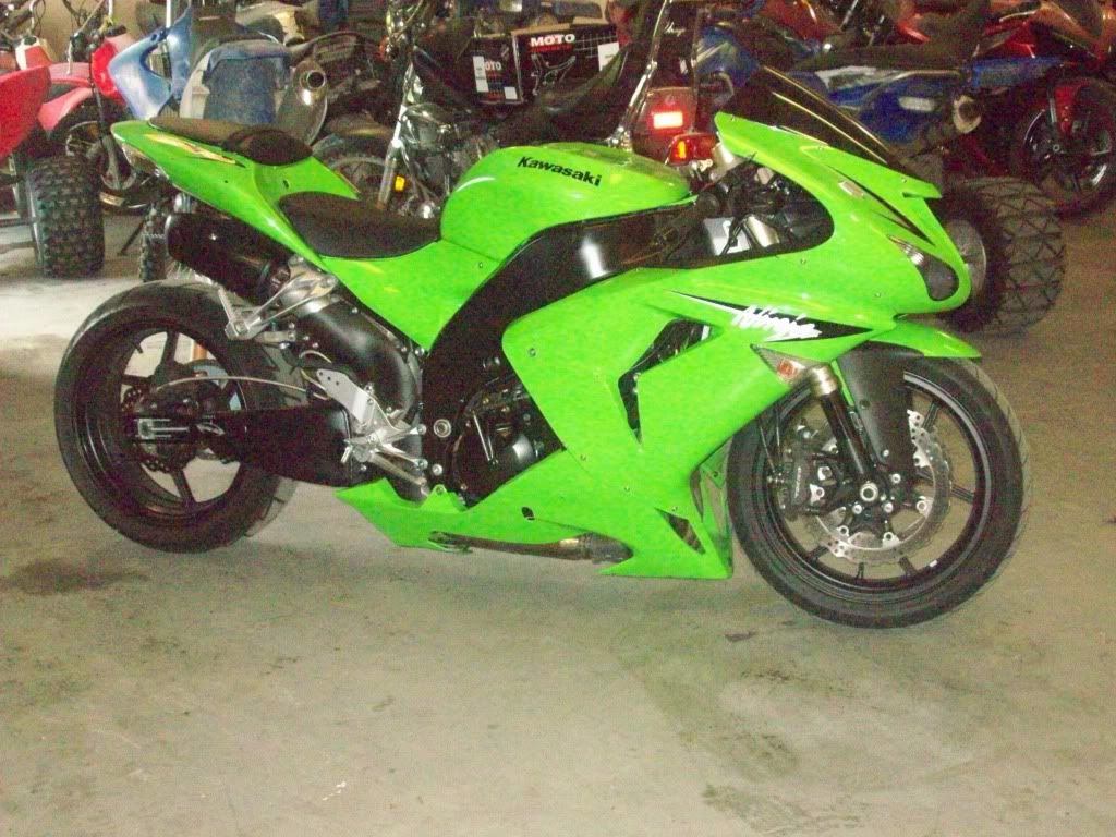

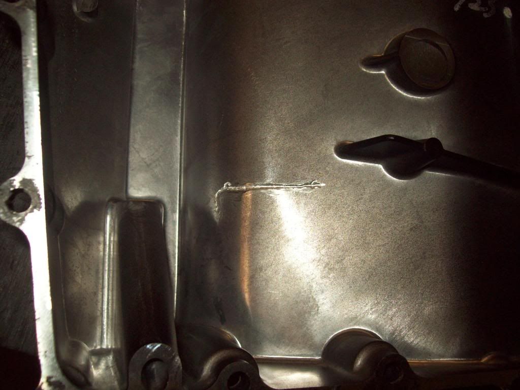

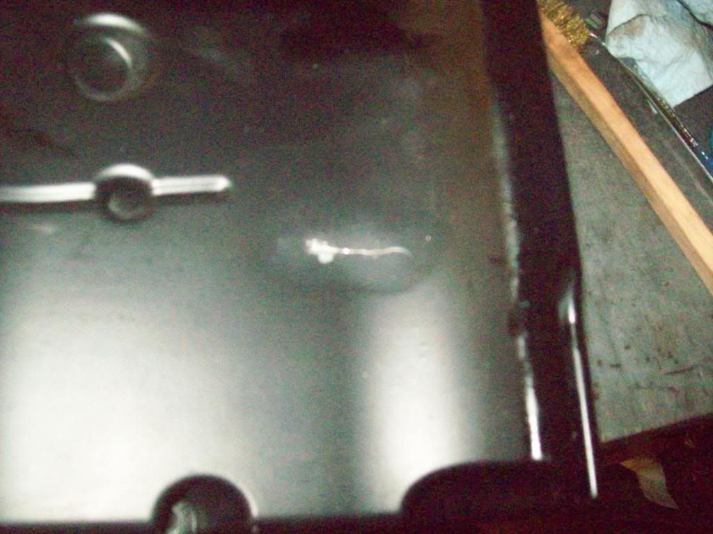

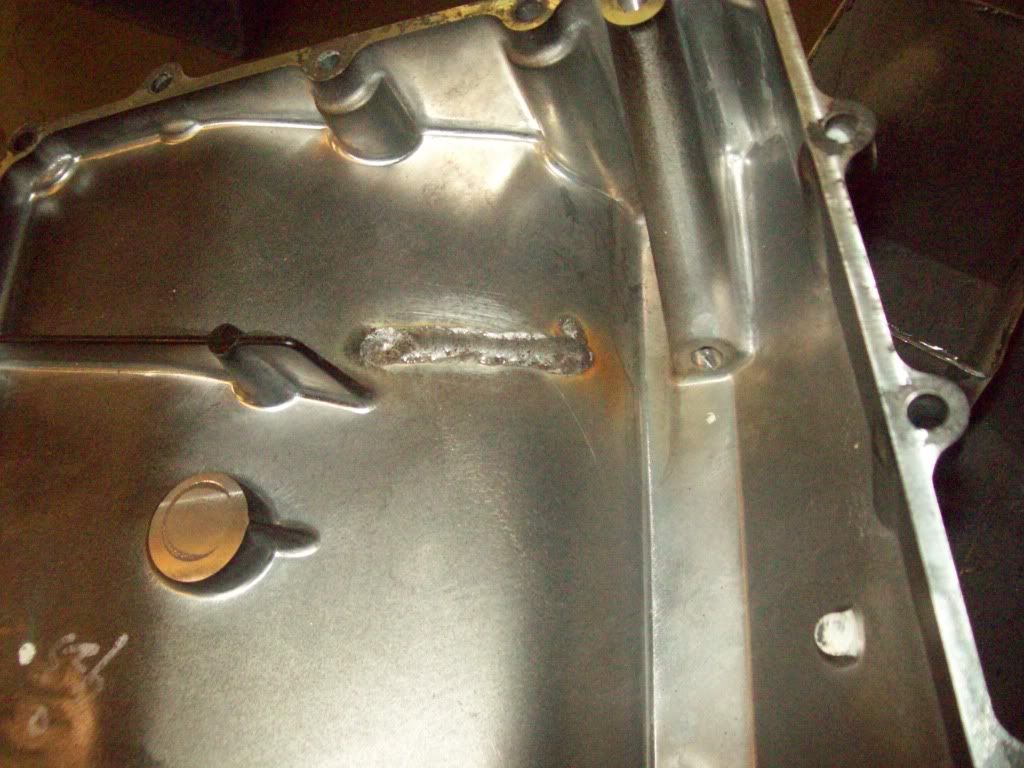

and an 07/08 ZX10R oil pan that got cracked when the bike bottomed out (slammed/stretched) and the exhaust got shoved up into the pan.
this one needs a battery box.
i formed it with only my mind
yes i know. i fried the end. got too happy with the pedal. stfu. i fixed it
lust at my gangsta ass V block, bishes.
see? fixt
perfect ass fit, of course
cracked 10R pan
V-eed out for welding. been heated up already (being cast.. gotta pre and post heat)
don't think i had the gas cranked enough at the start.. coulda been contamination too. thus the orange. don't know.. never will. welded and fixed.

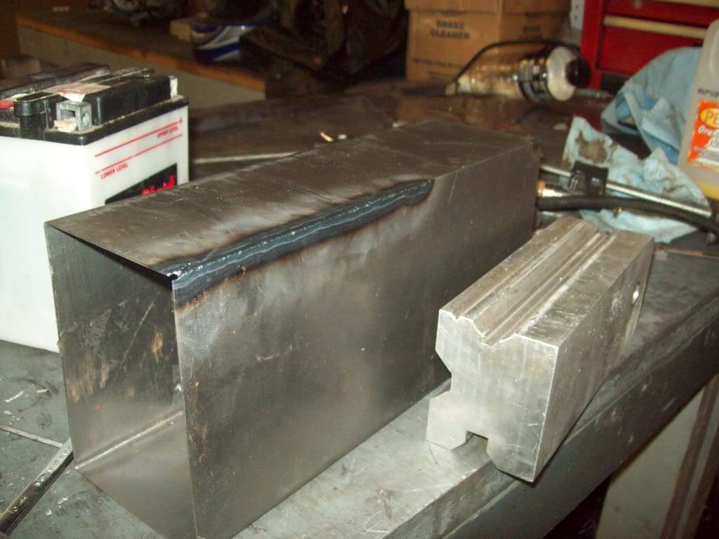

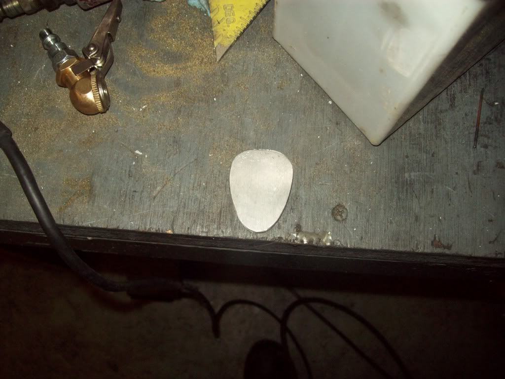

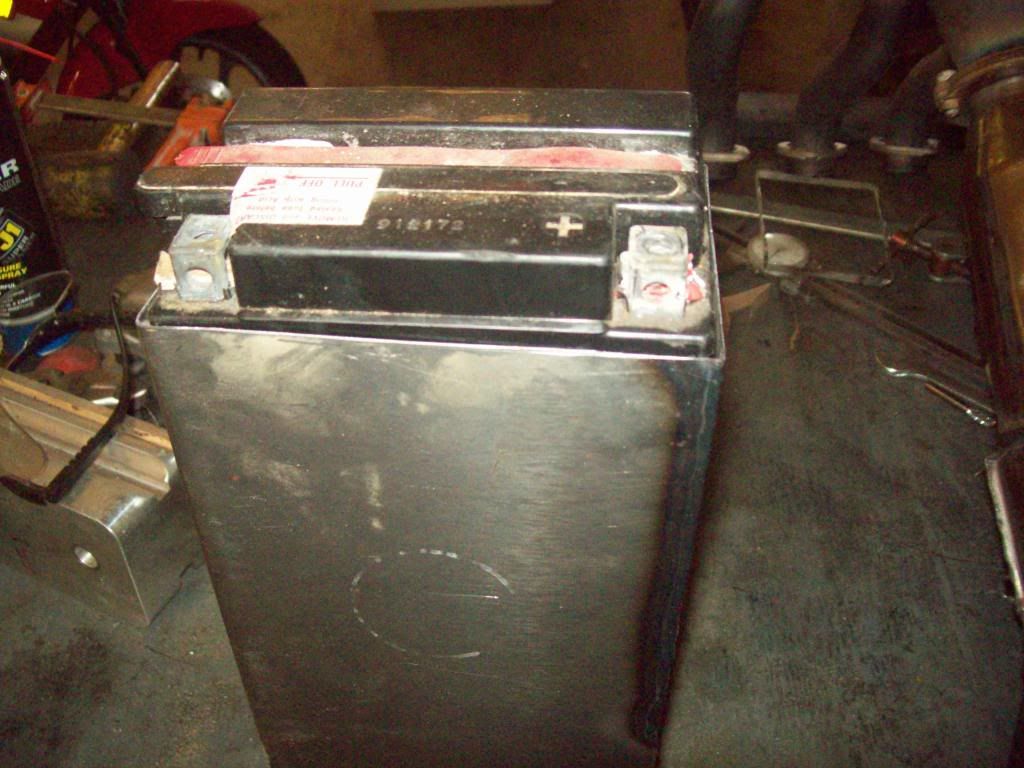

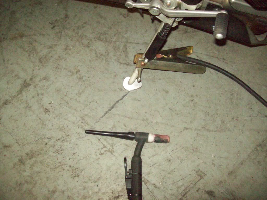

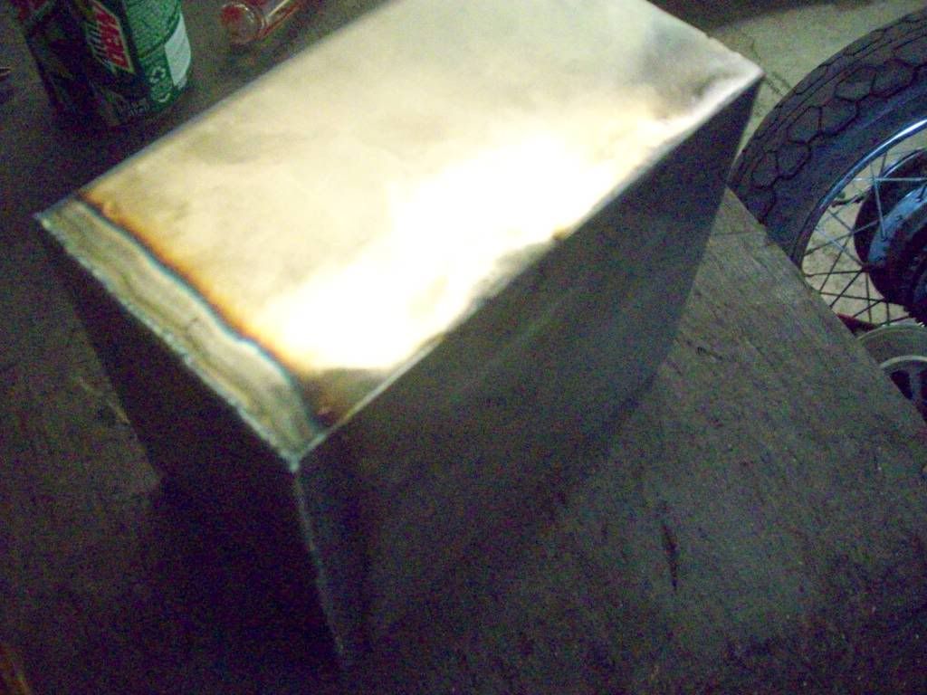

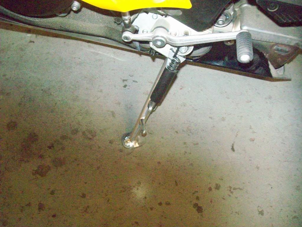

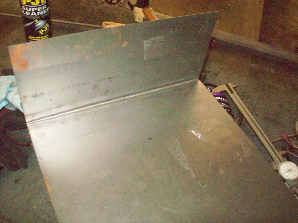

ok. finished an R6 kickstand and the battery box today.
now, i'm no TIG welder, mind you. i know enough to be dangerous.. so.. ya. it's not perfect but it works and will hold and doesn't look too bad at a distance. lol
i think i am getting better tho.. IMHO aluminum is alot easier to weld.. .. well, sometimes. lol
that kickstand fought the fuck out of me.

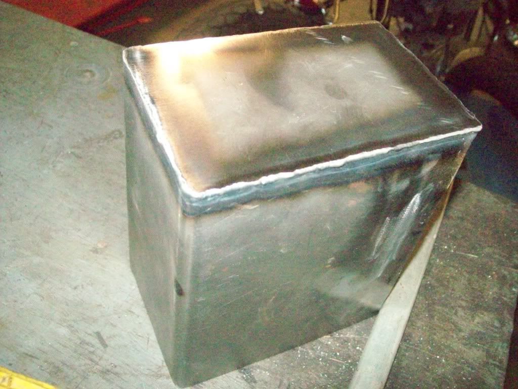

autogenously welded (no filler) on the box. 4043 rod (aluminum) on the R6 stand.

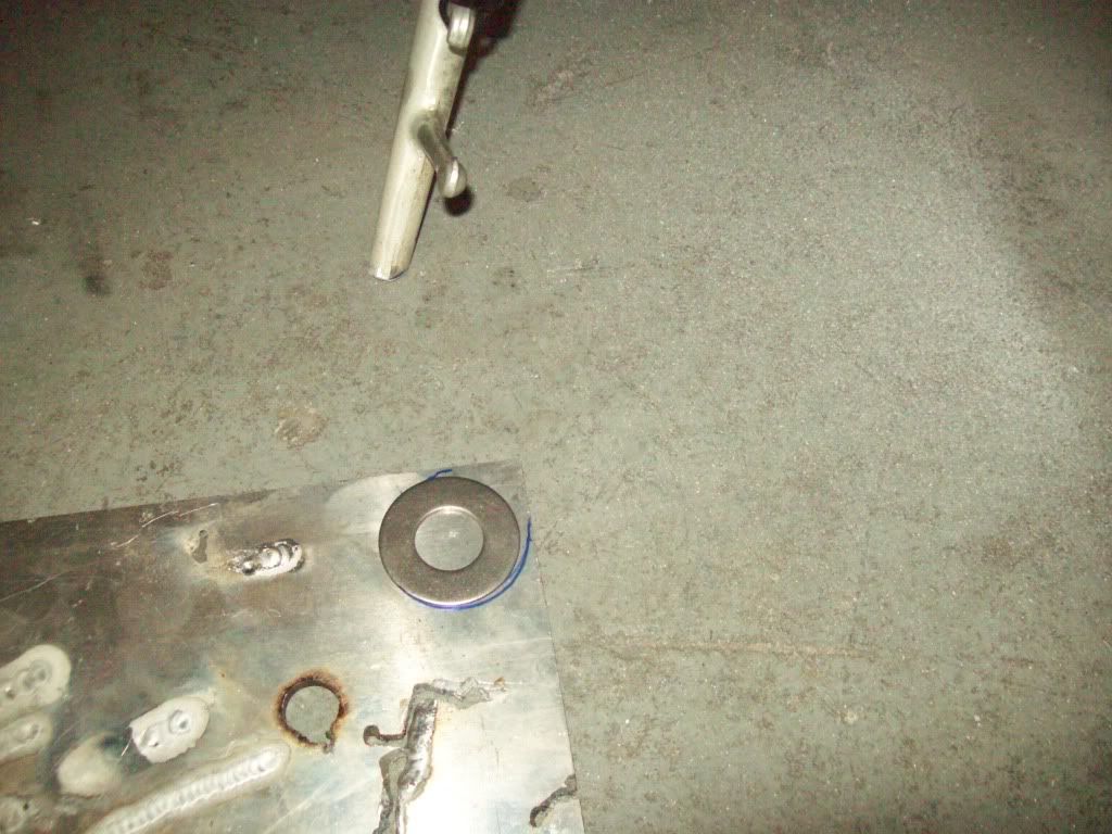

traced rought outline and nice radius with washer..
ECU unplugged, battery unhooked.. tacked then removed and slapped in a vise for the rest.
box
