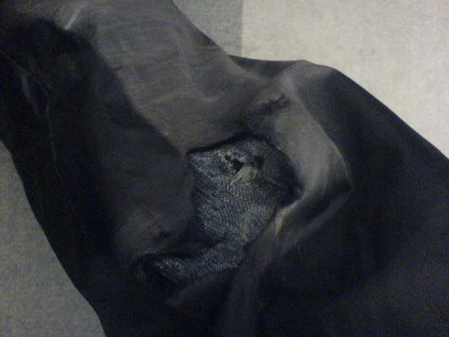

Since it was cold I had a hoodie on, my leather and then a wind breaker. I had nylon pants on over my jeans. My nylon pants are ruined and there's a hole in my wind breaker... Bodily harm was minimized to a very very small bruise... :)
