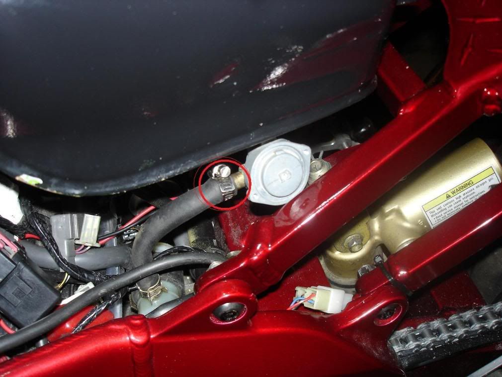

First, remove whatever you need to to see all the tank bolts. Then remove the gas tank bolts.
Disconnect the fuel petcock after turning it to the off position.
Disconnect the carburetor fuel inlet hose

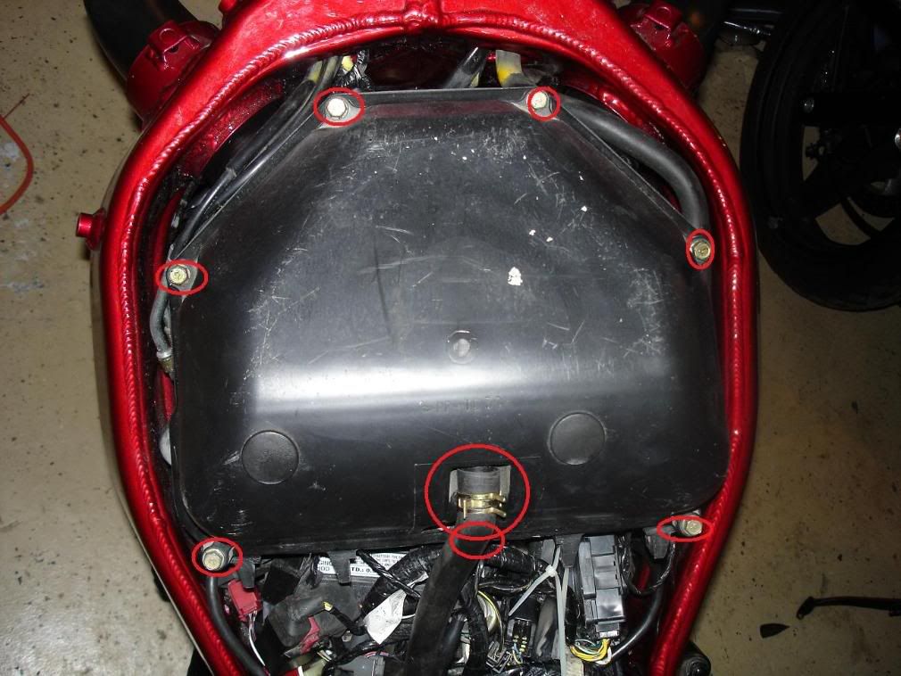

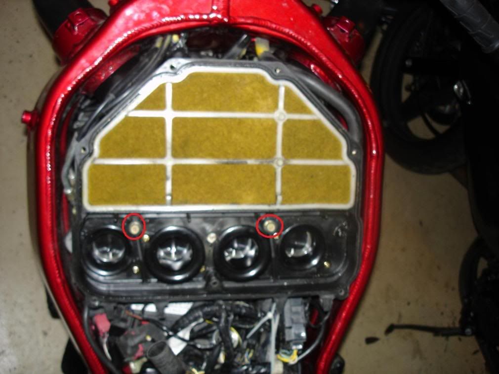

Disconnect hoses going to the airbox and the screws holding the top of the airbox on
REmove the lower part of the airbox by removing the screws holding it down and whatever hoses are attached

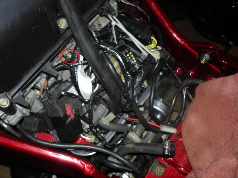

Disconnect the carb vent hoses

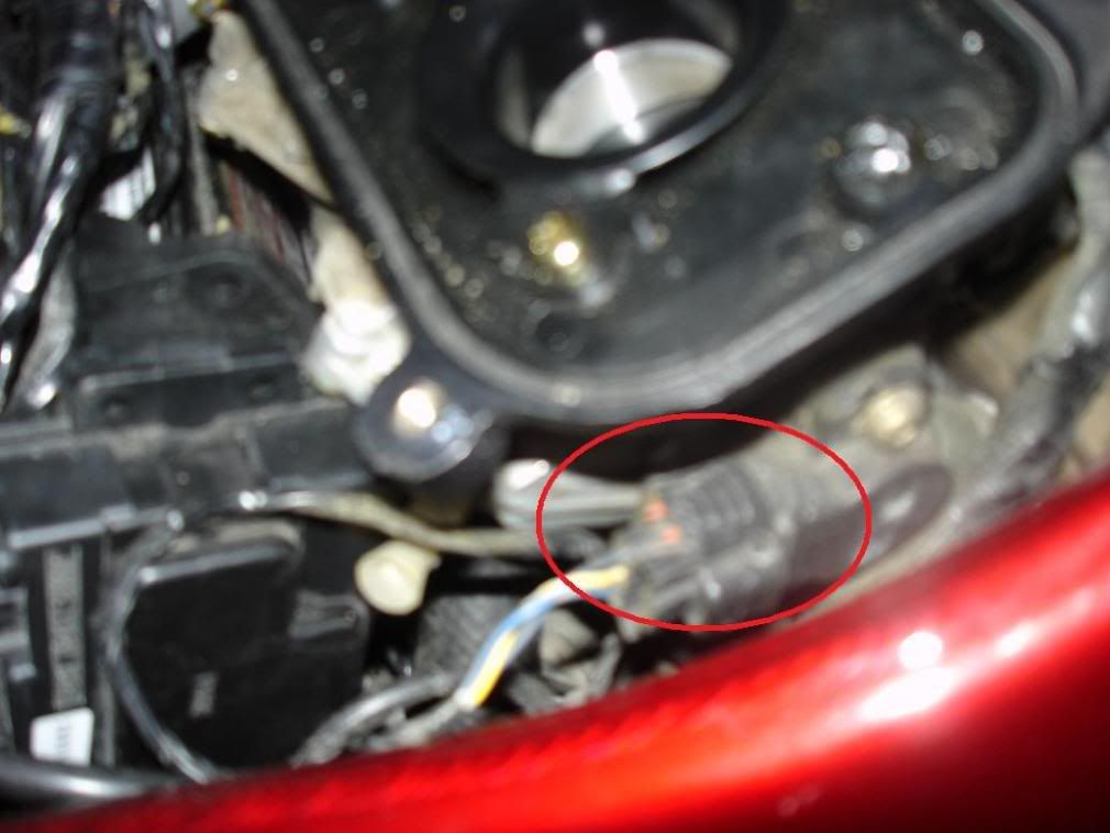

Disconnect TPS on right side of carbs (sitting down on bike)

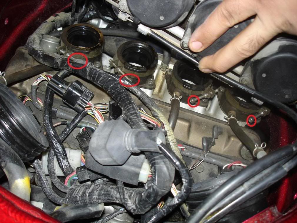

Loosen clamps and pull carbs out of boots. I would cover the holes with paper towels or something immediately to keep things from falling in there by accident

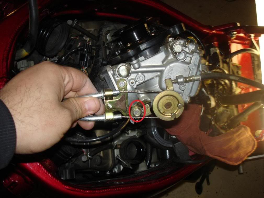

Remove throttle cable bracket to make it easier to take the cables off, then disconnect the cables
Disconnect the choke cable, pull it out of the bracket or some bikes just unbolt the bracket that holds it

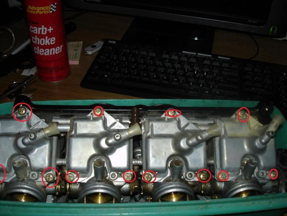

Loosen and remove all the float bowl covers. They can strip easy, so i would recommend using vice grips to loosen them all up initially. works like a charm

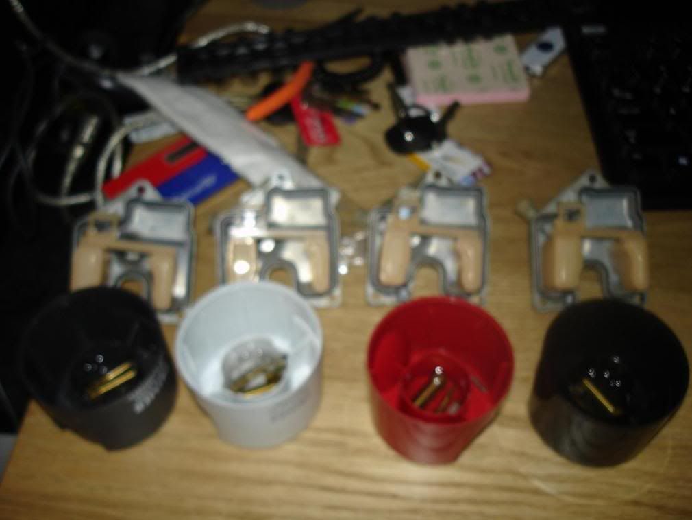

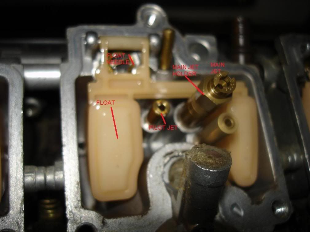

These are the parts of the carb that interest you. If your bike isnt idling, the pilot jet is prob dirty. if its sputtering at the top end, check the main jet. If it floods or something, check the float needle as there may be crud binding it up
Remove the pin holding the float in, something small helps.
Remove the screw holding the float needle valve and remove if necessary... sometimes they are pressed in and not meant to be removed.

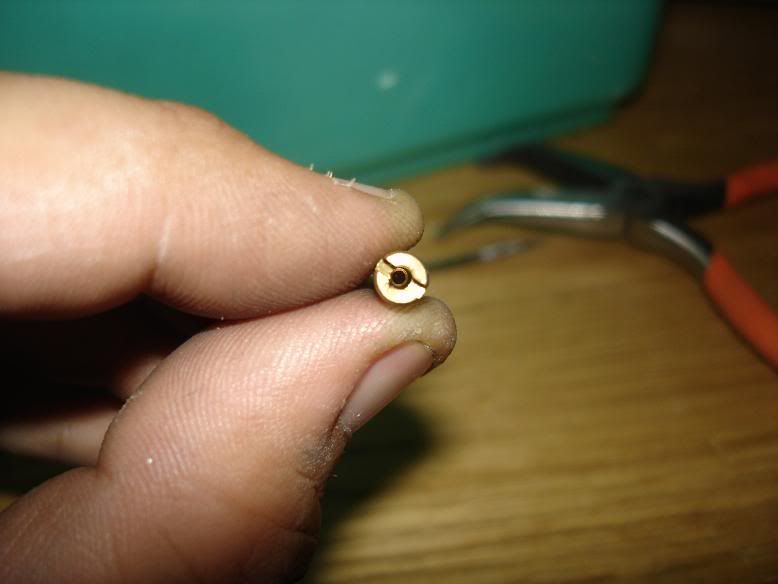

Check the pilot jet after removing it. See if you can see light through it. 2 of mine were showing no light , hence the sputtering.
Soak everything good and remember what went where. Sometimes there are different jets in the inner and outer banks and you don't want to mix those up

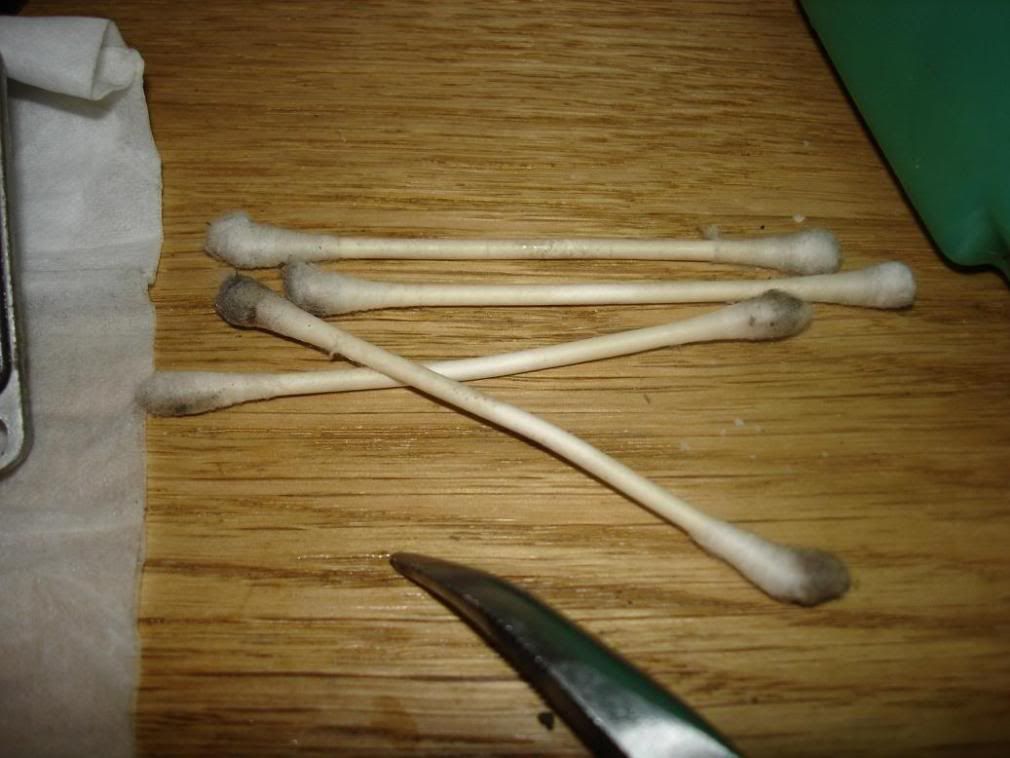

Blow some air through everything and reassemble. I cleaned my carbs in the little places with q-tips soaked in carb cleaner. that seems to work well with the tight spaces

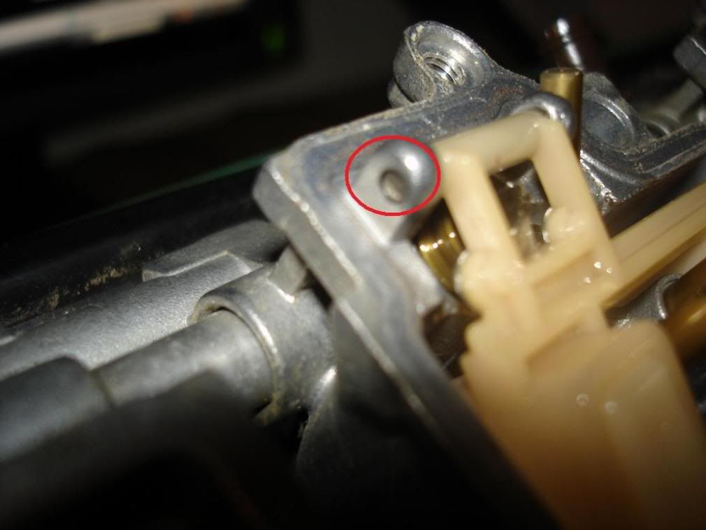

Originally Posted by Quick VR4 View Post
nice writeup. Can you tell me where the mixture screws are located?
you have to drill out the caps over them. look at the pics of the float bowl... theres a cap in a hole with a tiny hole through it. thats gotta come out... its under there
