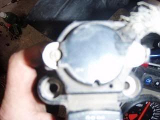

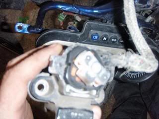

you don't HAVE to drill them out. use a dremel with a 1" cutoff wheel and slot the nubs at the end of the screw. you'll have to cut into the casing a bit, but it's ok.. won't hurt anything by doing that.
after you get a nice lever clean slot on the screw, you can back em out with a small flat screwdriver AND reuse them. sorry the pic sucks, but on the left screw, you can kinda slightly make out the slot i cut into the nib, running vertically.
watch the spring loaded contact block under there!!!!!!!!!!!!!!!!!!
