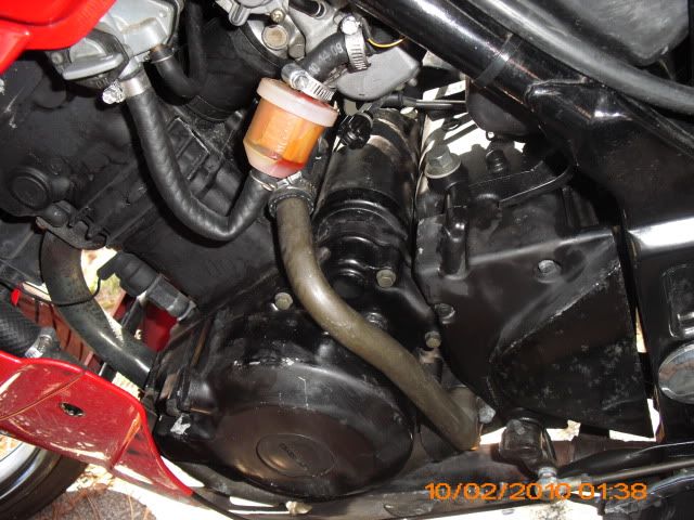

So I recently purchased an 01 Ninja 250 and just got her running. When I got back from a very short test spin I noticed the engine was covered in oil. I'm unsure of where the leak is at the moment, but oil appears to be leaking out of the left side of the top of the engine (crankcase if I'm not utterly mistaken). However, there is also a large amount of oil on/beneath (more beneath) the airbox. I'm going to clean the engine off and attempt to determine more precisely where the leak is, but if anyone has any ideas to the problem, all help is appreciated.

Before it was running:
After I rode it for a small amount:

to be honest, you will be better off going to the guys house with a bat, asking for your money back lol. it even looks like it had been cleaned previously in your "before" pic due to the paint looking slightly chalk like.
#4 ·
and your fuel line to your petcock is kinked... you got ripped off dude. next time you go buy a bike, have a gearhead go with you.

The bike is old, so you need to get the valve clearances checked.if you say you think its coming out of the top, that is the valve cover. if you can do the stuff yourself more power to you. the older 250s are easier to adjust. when you open it up and adjust the valves, re-seal it.
clean the entire engine. this way you can better detect. some oil leaks look really big but are actually very small, it just looks that way because its been leaking a small amount for a while and built up.
Actually... honestly, i would strip the whole friggen bike apart. take the airbox out, carbs out. clean the hell out of everything and replace as many gaskets on the engine as you can if you cant figure out where it is coming from.

Well I can't see anything in my oil window, so either it is completely full or completely empty? It has been sitting for almost a day now. From the pictures it looks to me like the leak is from where the silver and black get screwed together. Not sure what that's called, and it's a little hard to see in the pics.
Edit: I mean the cylinder head gasket is where the leak appears to be coming from. Possible?

Drain the oil and refill with the proper amount first. See how it runs then, if it is infact over filled with oil that could cause your problems. Otherwise it looks like your valve cover gasket is leaking, but that wouldn't explain the oil being burned in the engine, for that you'll want to check the piston rings and valves. Sounds like you bought without checking it out first, lesson learned.

I've stripped down the bike and I'm going to drain the oil, fill it up with new oil, replace the oil filter, clean the engine, and run it to observe where the leak is. There is oil in my airbox however, does that give a clue as to the problem?

oil in the airbox can only come from one place, the crank case breather. the crank case is vented to the airbox. when the engine oil is overfilled or you have been riding long distance wheelies(i'm sure that's not the case here) the pressure created in the crank case from the pistons coming down on their intake and combustion strokes forces the excess oil out of the vent and into the airbox. if there's enough oil forced into the airbox it will make it's way into the cylinders through the throttle bodies or carburetors. enough oil and you'll hydrolock and possibly do serious SERIOUS damage. the damage can include bent valves, connecting rods, blown head gasket, etc. excess oil can also cause other seals to leak even if the engine doesn't hydrolock.
the moral of that story is do not over fill your engine oil.

I replaced the oil (couldn't replace the oil filter and I rounded the head of the oil filter bolt) and cleaned the engine. It wasn't smoking any longer, and I could not detect an oil leak anywhere. The oil light was off, and even after a ride there was no oil. I have no idea what the problem was, but it appears to have been cleared up.
