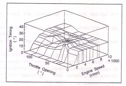

hahaha....that's funny....Being kawasaki Mechanic and Certified for 5 years with best marks in each class I can say with strong confidence that Kawasaki does things to be responsible far more then you would assume.
The throttle position sensor DOES give optimal performance for STREET riding....It is a race designed street bike. If it was for a crusier or something else then it could be optimal for maximum performance.
And after Canada Kawasaki's Head Race Mechanic says to unplug it and the bike will be better suited for racing, then that's kinda a no-brainer.
And to be backed up by more performance, my new Dyna 2000 ignition module omits the TPS. And when asked why, they said it was unnecessary for full performance.
....and too I have worked on bikes for 10 years or so, but WTF do I know?...I'm just some guy on the internet.
it's all about application.....secondary butterflies on fuel injection to smooth out the jerkyness of throttle response...many racers remove them for road and drag racing, to get rid of restriction in the air passage.
And to squash any notions that it was sabbotage to make competition slower, this advice was given so a loacl amature could better his machine at the National tour stop.
another example of Kawasaki limiting power to make for a smoother machine is the KVF650 4x4 and how they set the ignition for that. Unrestricted with a Dynatec box and they become a hairy beast....top end power is the same but the ignition curve is so agressive that it feels like the bike is a different machine....
With similiar results for the ZX6R's it's more agressive and potentially less an enjoyable street ride for the new rider.........and to add, that Kawasaki doesn't have to make this technology, alot is sold to them and they purchase it from Mikuni/mitsubishi who makes their carbs and ignition CPU.
