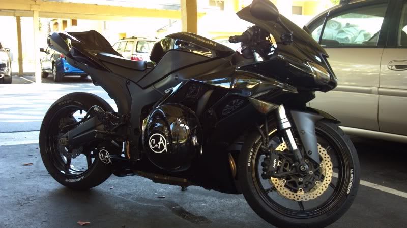

So for the longest time I have been anticipating a crash and had all kinds of plans to do a fighter build afterwards, well I finally got tired of waiting and decided to just go for it. I am still taking baby steps at the moment as money is sort of an issue but never the less, ITS ON BITCHES! I am super pumped about the easy things are going so far and don't plan on being finished for quite some time. Now for the pictures
This is the bitch! Taken a couple of weeks ago
And right before tear down
Now even before taking it apart I could see I was going to have a issue with the front end. The intake portion of the frame sticks out way past the forks!
I forgot to take a picture of the harness before I started moving it :( but fairings off
Couldn't just leave the harness the way it was, wouldn't reach where I needed it too so I had to open her up
And stretch her out, had to add about a foot and a half to the headlights, blinkers and gauge cluster portions of the harness
ok so the wires are out of the way but now the ignition looks like a dogs nut sack and the radiator sticks out like a sore thumb. Won't be having that

Holy crap, you were really serious when you told me you wanted to do a fighter build. Nice work so far. I too was going to suggest what Tyler said and chop off the intake on the frame, but if you can get everything mounted up without issues then I wouldn't bother.
Are you going to run around with clip-ons or are you going to go with dirt bars? The dirt bars really set off the look of a fighter, plus they make the bike way more comfortable. They even give you more leverage with countersteering, which results in a very flick-able bike.
Gonna subscribe now. I assume your build is on customfighters too. Yes?

Ok so I have been kind rushed to get this thing road ready because of the accident, headlight I'd painted and mounted even though the leaping came our like total dog shit. I'm still trying to mount the gauges and I'm not to happy with it.
