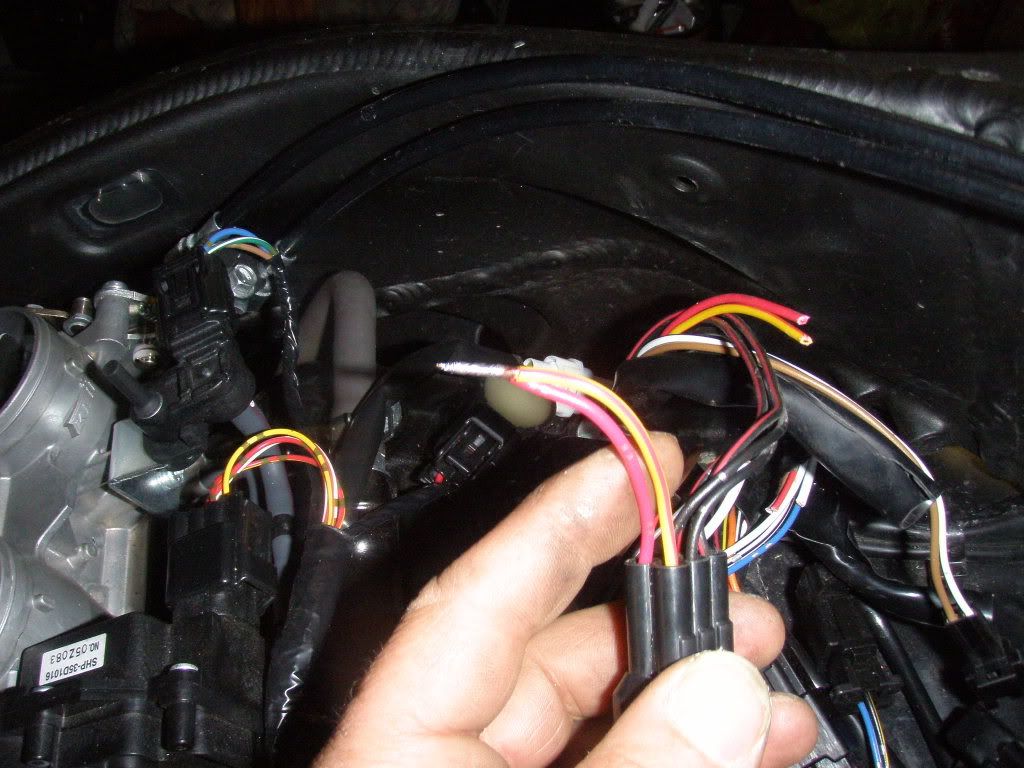

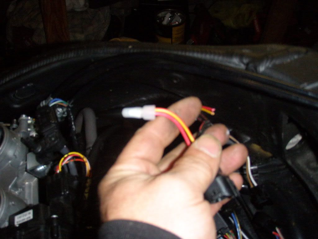

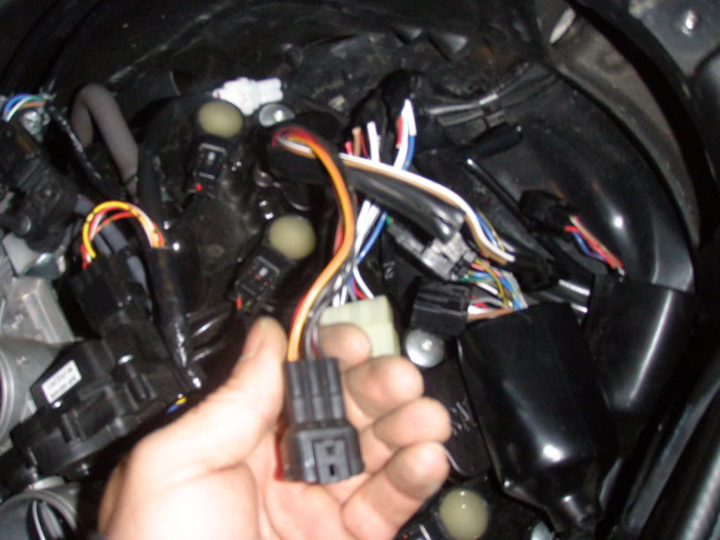

The location of the two plugs to access the wires is under the tank and airbox. We are looking for the ignition connector and the start/stop connector.
Here is the ignition plug
the start/stop plug
I cut the white, gray, brown, and red wires. Remember, red is optional
Cut the yellow/red and red wire from the start/stop plug.

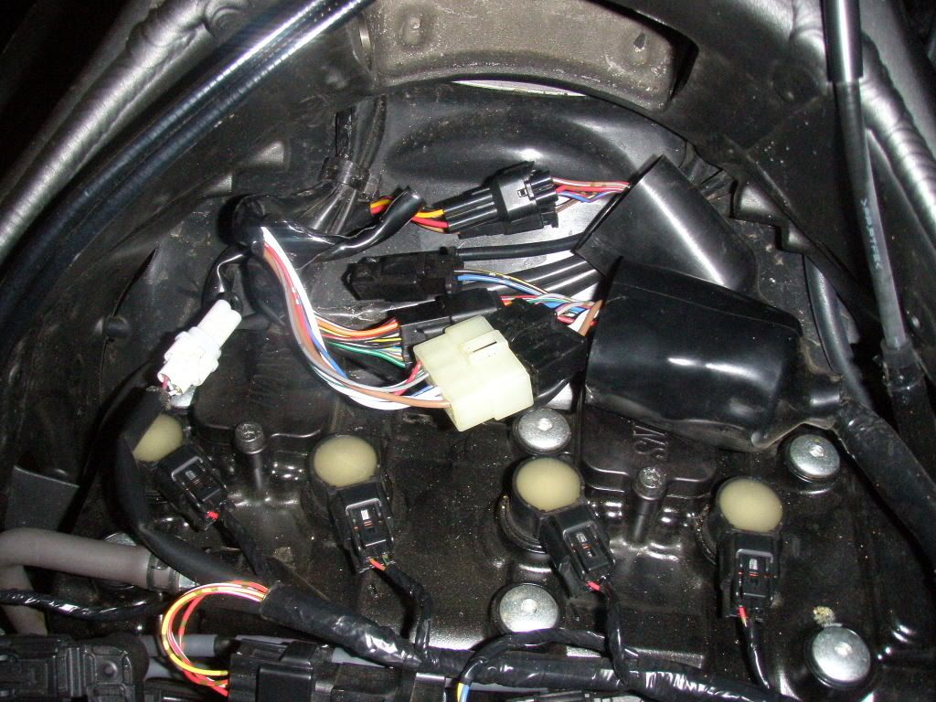

#5 · (Edited)
now on the ignition plug take the white wire from the plug side and splice it either wire from the start/stop switch, i used the red wire from the starter switch. take the gray wire from the plug side and attach the 100 ohm resistor
now all that is left is the yellow/red from the start/stop switch and from the ignition plug the gray with the resistor, the brown which will power your ignition fuse and my optional red which will power my accessories. i twisted the 3 from the ignition plug together and soldered them to the yellow/red from the start/stop switch. some shrink tubing and electrical tape to finish it off plug both connectors back in
fired it up and it all worked out somehow:dunno:
